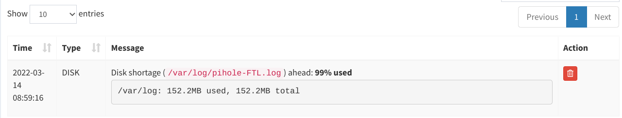

作者: SAGAQWE    时间: 2022-3-14 18:52
回覆 2# fakeman
睇番log内容,又干干净净。。
[2022-03-14 10:51:02.336 1320M] Resizing "FTL-dns-cache" from 28672 to (2048 * 16) == 32768 (/dev/shm: 1.9MB used, 253.2MB total, FTL uses 1.9MB)
[2022-03-14 12:13:08.552 1320M] Resizing "FTL-dns-cache" from 32768 to (2304 * 16) == 36864 (/dev/shm: 1.9MB used, 253.2MB total, FTL uses 1.9MB)
[2022-03-14 13:29:44.725 1320M] Resizing "FTL-domains" from 36864 to (2048 * 24) == 49152 (/dev/shm: 1.9MB used, 253.2MB total, FTL uses 1.9MB)
[2022-03-14 13:48:00.372 1320M] Resizing "FTL-dns-cache" from 36864 to (2560 * 16) == 40960 (/dev/shm: 1.9MB used, 253.2MB total, FTL uses 1.9MB)
[2022-03-14 13:49:55.923 1320M] Resizing "FTL-strings" from 81920 to (122880 * 1) == 122880 (/dev/shm: 1.9MB used, 253.2MB total, FTL uses 1.9MB)
[2022-03-14 14:39:19.669 1320M] Resizing "FTL-dns-cache" from 40960 to (2816 * 16) == 45056 (/dev/shm: 2.0MB used, 253.2MB total, FTL uses 2.0MB)
[2022-03-14 15:45:07.808 1320M] Resizing "FTL-dns-cache" from 45056 to (3072 * 16) == 49152 (/dev/shm: 2.0MB used, 253.2MB total, FTL uses 2.0MB)
[2022-03-14 16:51:00.770 1320M] Resizing "FTL-dns-cache" from 49152 to (3328 * 16) == 53248 (/dev/shm: 2.0MB used, 253.2MB total, FTL uses 2.0MB)
[2022-03-14 17:20:30.846 1320M] Resizing "FTL-dns-cache" from 53248 to (3584 * 16) == 57344 (/dev/shm: 2.0MB used, 253.2MB total, FTL uses 2.0MB)
[2022-03-14 17:43:49.357 1320M] Resizing "FTL-queries" from 1376256 to (28672 * 56) == 1605632 (/dev/shm: 2.0MB used, 253.2MB total, FTL uses 2.0MB)
[2022-03-14 18:30:17.005 1320M] Resizing "FTL-dns-cache" from 57344 to (3840 * 16) == 61440 (/dev/shm: 2.2MB used, 253.2MB total, FTL uses 2.2MB)
但web interface就出
图片附件: Screenshot 2022-03-14 18.48.37.png (2022-3-14 18:51, 33.07 KB) / 下载次数 186
https://global.hkepc.com/forum/attachment.php?aid=2310744&k=73d06cf51c1456ff417f9783edcbdc10&t=1792980537&sid=7soswZvUZa
